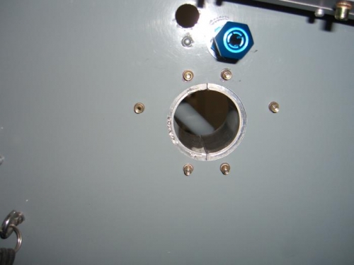

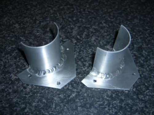

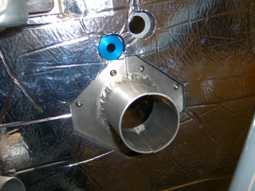

I made a firewall pass through for the wiring looms. I cut the pieces (all 1.6mm thick) to fit & a local welder did a nice job of the welding. This will eventually be coated in "Contego Fire Barrier" latex primer & then wrapped in fire sleeve.
Welding complete
In position, engine side
Cabin side
