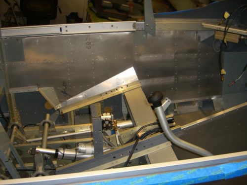

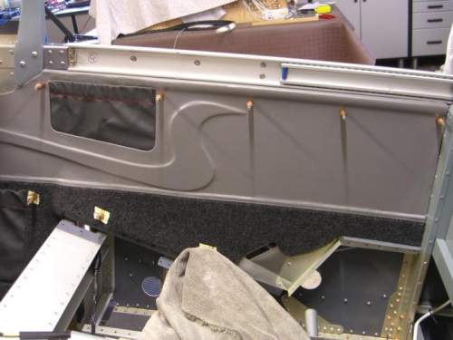

Today I installed the rivnuts for the sidewall trim panels. I used 4mm hardware & "J-B Weld" to secure them.
Clecoed in position
Same screw pattern/positions as the factory aircraft

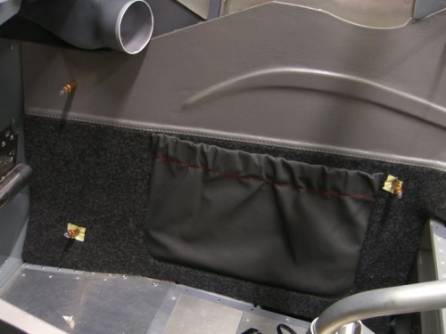

Rivnuts installed
