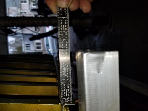

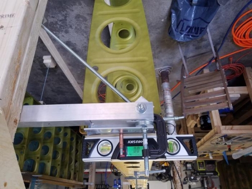

Brief Description:  Removing twist from the wings on the jig
Today covered a lot of ground but didn't get much done. Yesterday, I removed the wing skins to double check the alignment of the wings prior to match drilling the skin. I was able to successfully level the wings and check the structure for twist using plumb bobs. However after doing all the alignment work I made the absent minded decision to MOVE THE WING JIG (bad idea), negating all of the work I had done. So today I took the time to check the alignment of the right wing and align the left wing at the top and the bottom of the skin. Then I hung the wing skins on the left wing using cleco's in every fourth hole.
