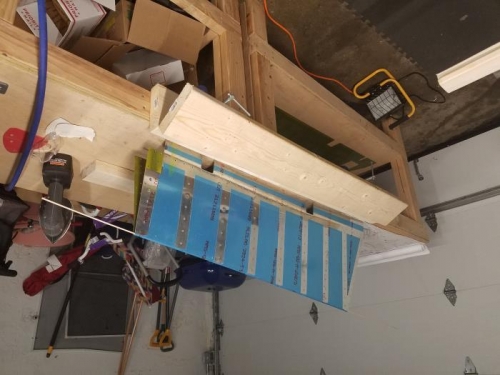

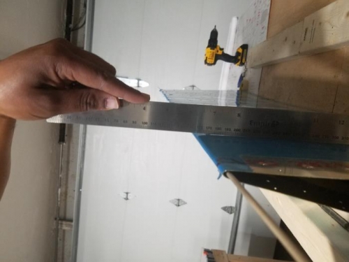

Date:  6-20-2019
Manual Reference:  Sect 6-8
Brief Description:  Right Elevator Skin Bending
This log entry record record my efforts to bend the trailing edge of the right elevator to the proper angle prior to final riveting of the right elevator. I used the two 2"x6" board connected with door hinges to attempt to bend the elevator skins down to the proper anlge. I used two different ends of the boards, I used the long ends (6") to slowly work the skin back down from its initial angle. Then I used the short ends (2") to attempt to make the final bends. While I was able to bend don the skin significantly, I still have to work on the skin to get it down to the proper angle.
