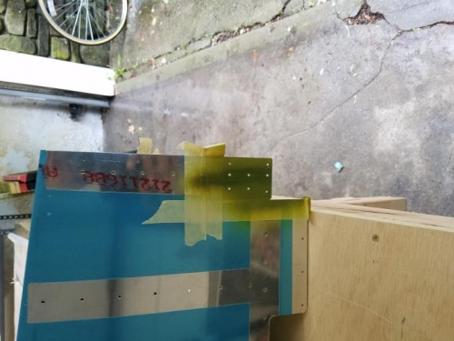

Brief Description:  Right Elevator Assembly
Unsure whether the E-713 Counter Balance Skin went underneath or over the top of the E-701R Skin. therefore I scuffed and primed the outer corner of the E-701R Skin. After consulting with the Vans technical counselor I learned that the counterbalance skin went underneath elevator skin. After the elevator is assembled the primer will be removed from the skin and the counterbalance skin.
