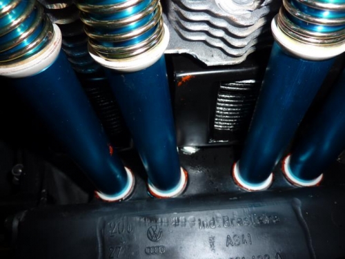

Brief Description:  Removed and Replaced push rod tubes

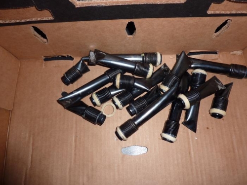

I was very careful on initial installation to make sure original tubes supplied by Sonex with my AeroVee were streched the same amount. They started to leak right away after just a few minutes of run time. Tried to wiggle the tubes to help them seat but that did not work. Gave up after numerous tries.
Purchased new spring loaded tubes, cut out old tubes and installed them without having to remove the heads. More junk for the AeroVee scrap pile
Spring loaded tubes installed
Crankcase view of new tubes
More AeroVee junk for the scrap pile
