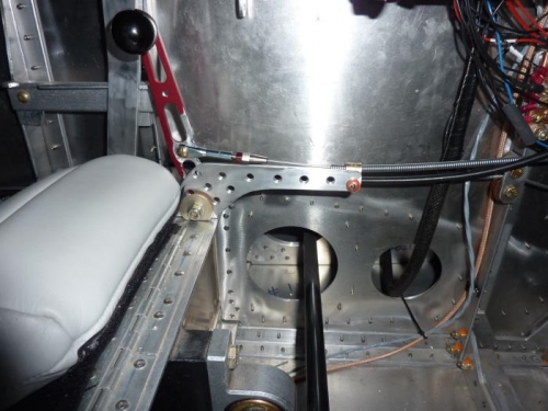

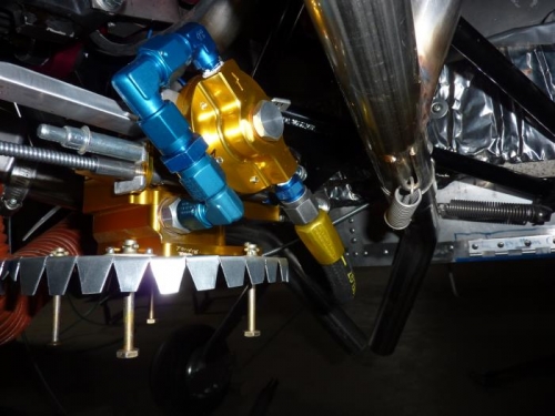

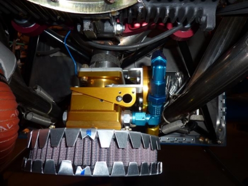

Brief Description:  Removed the Red Menace and Installed Rotec TBI
Removed the AeroInjector and replaced it with Rotec TBI. Installed additional filter in gas line, fuel pump, and regulator. Also replaced air filter with K&N filter that is much larger. Only thing I am using is the red handle from the Sonex supplied stuff. Used solid wire throttle cable with wire grips for much more positive control of the slide gate on the Rotec. With all the issues I had heard about with the soft cable bending on throttle closure, I was not going to try that. I see that in the latest AeroInjector manual, Sonex has gone away from the cable application and went to the solid wire. It was a little late for me
Rotec TBI and K&N Air Filter
Rotec Fuel Regulator
Mounted throttle on spar which seems much more comfortable to me.
