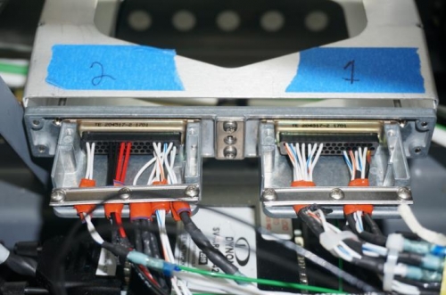

Installed the wires for COM 2 into the audio panel connectors.
Fabricated wires for IFD-400 TAWS warning and VOR/ILS audio and pinned them in place in the audio panel connector
Solder spliced the LH and RH Skyview audio out wires together to a single wire and pinned the wire in place in the audio panel connector.

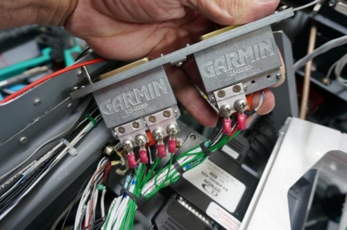

Installed ring terminals on all of the audio panel shield grounds and screwed them to the ground blocks on the bottom of the audio panel connectors.

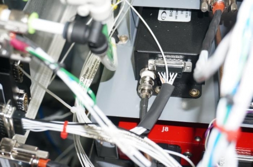

Cut the wires running from the SV-COM-Panel and the audio panel to the SV-COM-425 transceiver to length and installed D-sub receptacles. Installed the receptacles in the 15 pin D-Sub connector for the SV-COM-425.
labeled a 20 ga wire from the VP-X Pro wire harness kit and installed the pre-terminated end in the VP-X Pro J8 connector.
Wires pinned in audio panel
Sheild grounds on audio panel connector
SV-COM-425 Wire hookup
