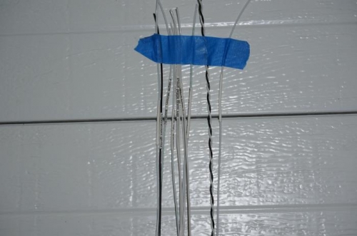

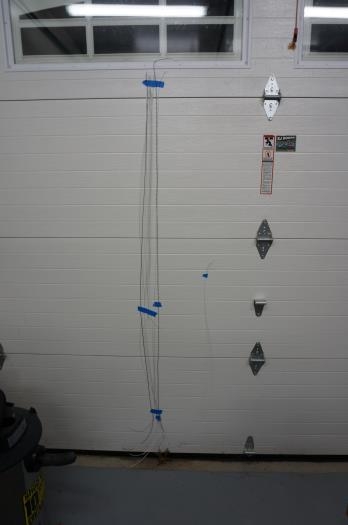

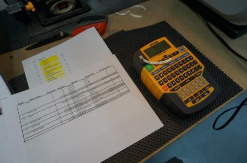

Cut the wires for the harness that will run from the pilot's stick CPC connector, through the RH gear tower and on to their various termination points. Labeled each of the wires and taped them to the garage door. Twisted two of the wires into a twisted pair for the pilot's push to talk switch using a cordless drill.
Making lables for the pilots stick grip forward harness wires
Pilot's stick forward harness wires cut to length
