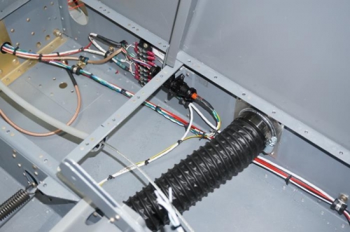

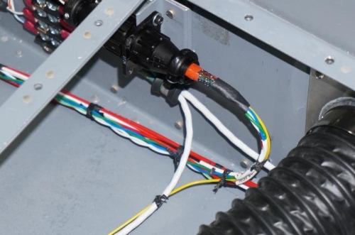

Roll servo CPC connector
Cut the aircraft side roll servo wires to length, installed D-sub pins, and installed the pins in the CPC receptacle. String tied the wires.
Cut the rear seat vent hose to length and installed it in place.
CPC connector for roll servo wires
