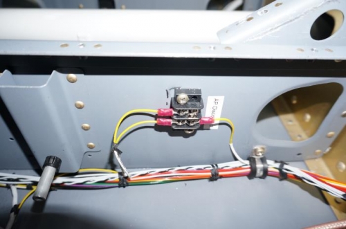

Brief Description:  AP disconnect wires and Com 2 coax
Cut the AP disconnect wires from the pitch and roll servos and pilot's stick to length. Added ring terminals to the wire ends and screwed them to the terminal strip.
Installed labels for the CPC 1, 3 &4 connectors and AP disconnect terminal strip.
Installed a BNC connector on the antenna end of the coax cable for com 2 and routed the coax through the spar and RH gear tower.
AP disconnect wire terminal block
