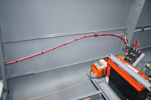

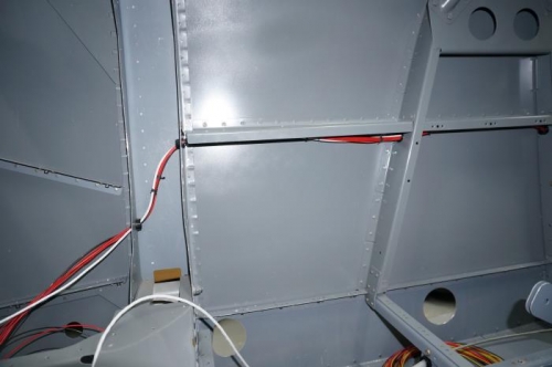

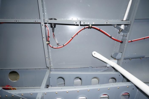

E-bus wire harness continued
Pulled the E-bus wires out from the snap bushings and Adel clamps. Removed two of the snap bushings, Drilled the holes larger and then installed larger snap bushings. Re-ran the wires, neatened them up and tied them together with string ties.
