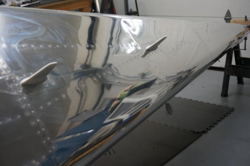

Received a package from Aircraft Spruce today that contained the star washers I ordered for use on the transponder and ADS-B antennas. Applied caulk to the bottom of the antennas, installed them and torqued the nuts in place.

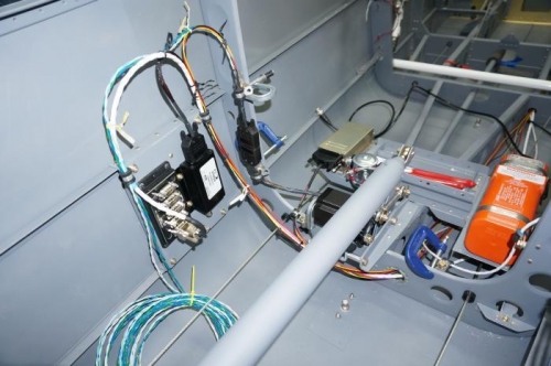

Tried an alternative routing for the wires in the aft fuselage because I didn't like how the D-sub for the pitch servo was supported and how it crossed one of the other wire bundles. I haven't decided which routing method I'll use, but I'm leaning towards the new one.
Transpoinder and ADS-B antennas in place
Alternative wire pass
