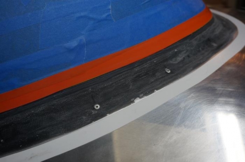

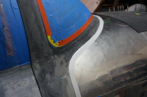

Brief Description:  More windscreen fairing work
Sanded the micro on the windscreen fairing. Removed tape from the edges and applied fresh layers. Sanded some of the windscreen to prep for more micro.
Drilled holes in the lower forward part of the windscreen fairing where it meets the upper forward fuselage skin and installed blind rivets.
