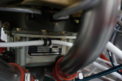

Crimped a ring terminal on to the contactor end of the starter cable. Secured the cable to the engine sump and engine mount using adle clamps
Cable clamped the engine sump bolt

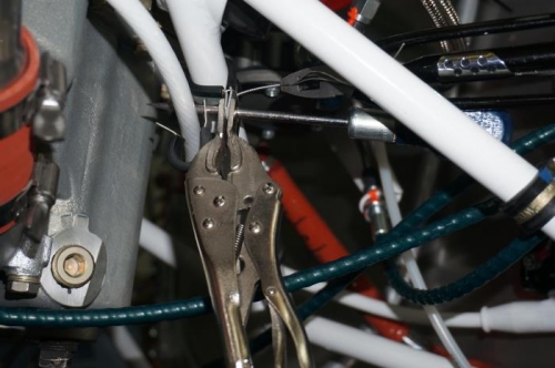

Using safety wire to temporarily hold clamp

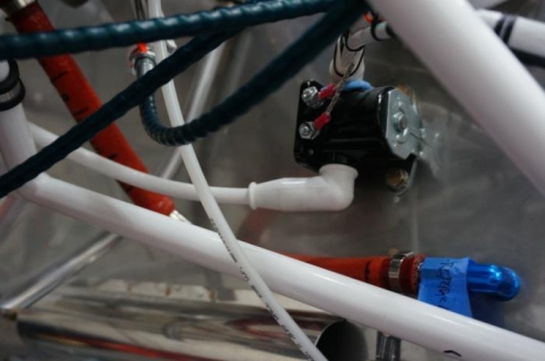

Starter cable connected to contactor
