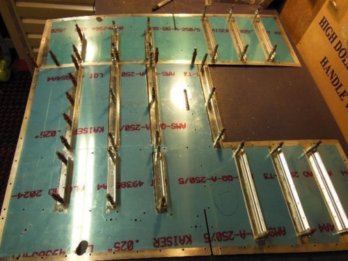

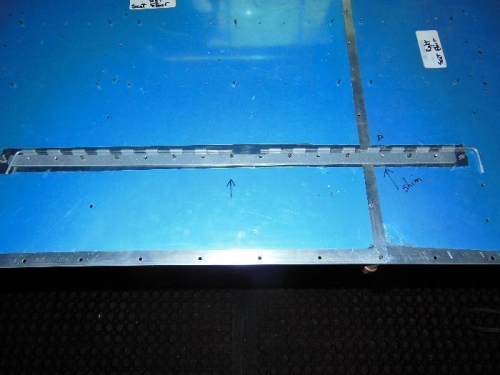

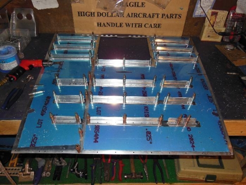

Seperated the 12 various floor stiffners. Smoothed and deburred all edges. Positioned and match drilled all rear seatback hinge holes. Match drilled corresponding stiffner with seat hinge. Clecoed all floor stiffners into positions and marked.
