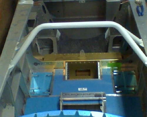

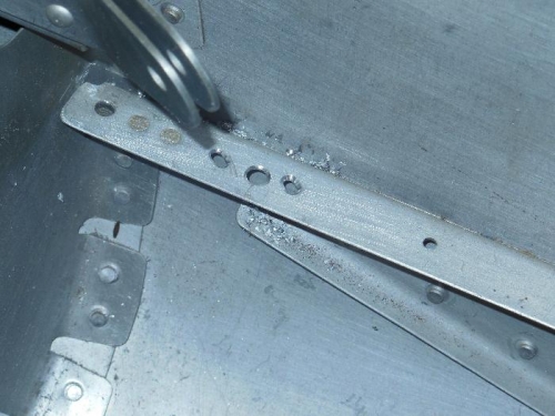

Assembled footwells and final drilled. Removed all floors and deburred. Removed flap act. weldment and machine countersunk the holes in the F-805F-1 spacers and floor support angles. Deburred and smoothed everything with 3M. After drilling the holes for the foward flap mount bearing block nutplates, I went to counter sink the attachment holes in a very cramped area and I really messed up. See photo. I ordered some platenuts with the two holes to the side just as in the rear platenut. I'll keep my fingers crossed and hope it works
