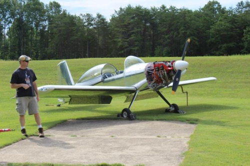

Removed both cowls.
Torqued lower plugs to 35 ft-lbs and upper plugs to 15 ft-lbs.

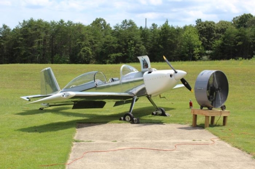

Engine Run #1 3 minutes at 800 RPM
No cylinder #2 EGT bar graph.
Idle cutoff setting needs adjustment.
Alternate air door movement.
Engine Run #2 3 minutes at 1000 RPM

Oil leak noted. Coming from prop governor.
Tightened upper governor attach bolt.
