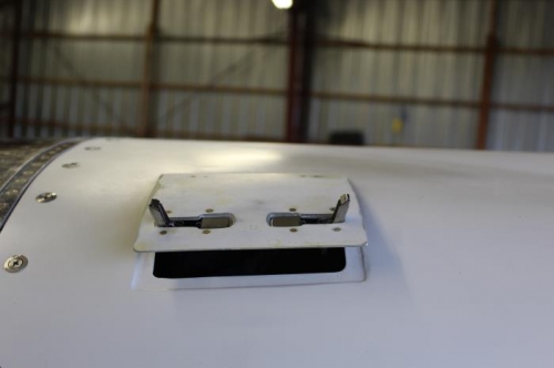

Sanded oil door.
Riveted latches to oil door and door to cowling.

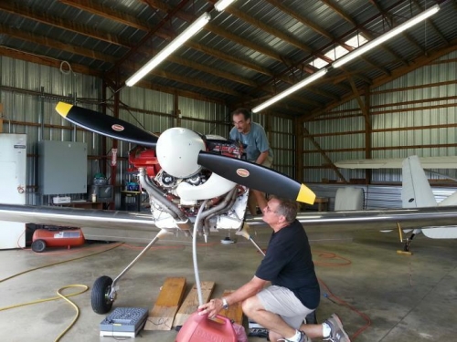

Drained preservative oil.
Installed and safety wired oil Safe Drain.
Added fuel to L tank. Disconnected fuel line at fuel servo and tested fuel flow.
Tested fuel flow in R tank.
Added 8 quarts of Aeroshell 100 mineral oil.

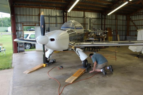

Weighed aircraft 3 times. Scales were rated 1-Good, 2-Fair, 3-Bad.
First weigh in: L2 550 R1 555 T3 63
Second: L1 552 R3 551 T2 61
Third: L3 549 R2 552 T1 61
Final recorded weigh in based on the Good scale:
L 552 R 555 T 61 Total weight: 1168 lbs.
