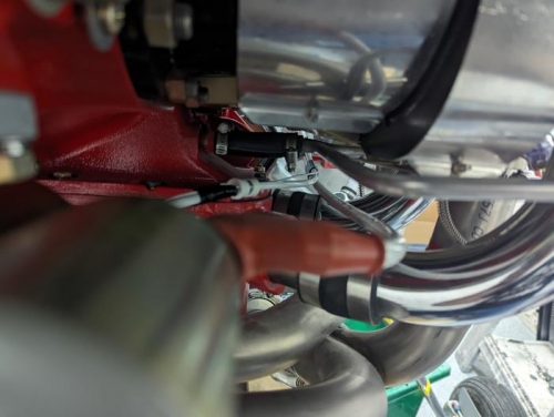

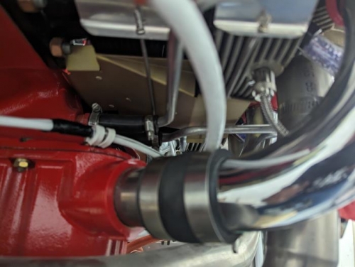

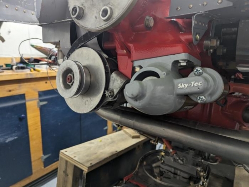

Today I installed and connected the alternator & the starter. Simple about what had to be done, to make a perfect installation required much manipulation, shortening the wire going to the alternator controller.
You can also see how I routed the cabling of both units in the second picture.

Alternator & starter
Cable routing
Cable routing
