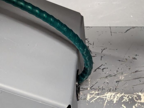

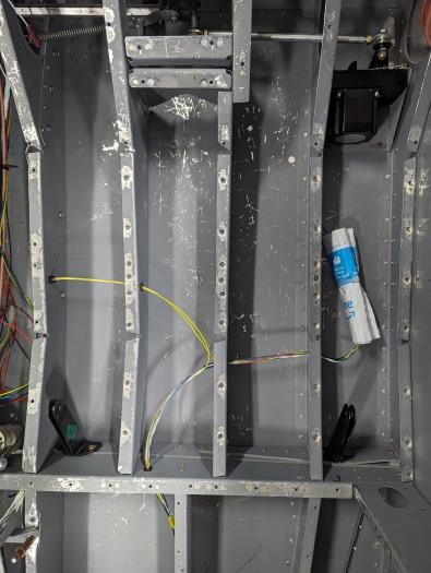

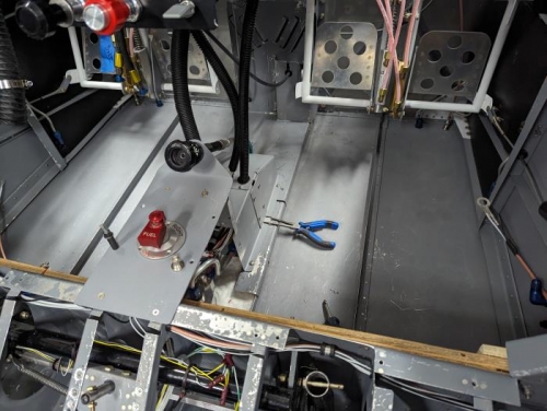

Today I kept on going, becoming ready for paint ie, having all the cockpit ready ... But unfortunately, there is a lot of  small fitting that takes forever to fix or simply do. For instance , to secure the screws of the roll servo, I had to unscrew it from under and pull it out of the cockpit to add the safety wires. Then reinstalling it after. One thing I did was to remove the plunger pin on the manual trim knob cable, a safety precaution. I am going to add at the end of the knob a 1" chromed plug to make it look good.  You might see the Amazon bubble envelope covering the 2 Dsubs connected together (from the servo) ; I had the choice of securing it against the floor rib so it wouldn't bounce around but I decided to put bubble padding because it is very light. That way I did not have to put holes in the rib ...a simple and faster way to protect the D subs.
Trim cable exiting the front console
Trying-fixing -tiewrapping wires ....
Under the co-pilot floor
