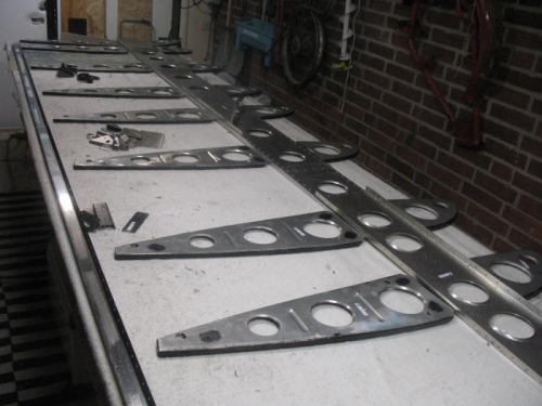

Brief Description:  Right wing frame

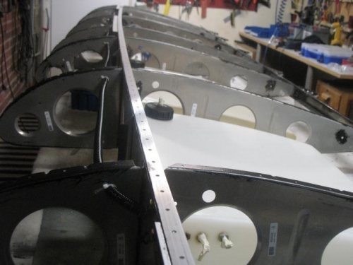

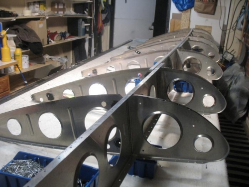

Today I realized that the wing is big. Took a long time to deburr, clean and anti-corrosion protect all the details. However, the frame work was easy to assemble because the manual, in this case, was unusually precise with all instructions in one place and with clear notes where NOT to rivet. The strobe line was clamped in place shielded by the corrugated plastic tube.
The installation of the tanks was another matter. I am going to install long range tanks (i.e two tanks in each wing) and I found the instructions for this operation to be scattered over four chapters (the spare parts list included).
Right wing laid out
Right wing laid out
Right wing, spars rivetted in place
R Wing w tanks and strobe line
