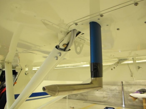

Brief Description:  Pitot tube and landing light

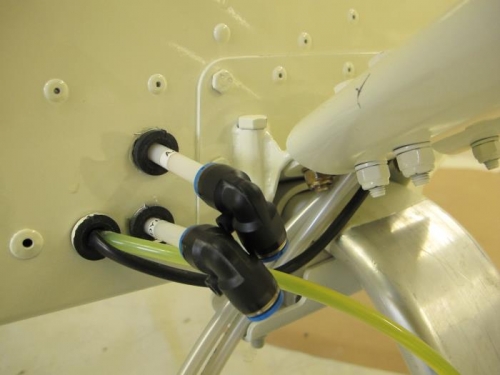

Once the wing struts were attached the air tubes for the pitot tube could be installed hidden in the strut. There is one line for each of the two orifices of the pitot tube, the dynamic pressure and AoA (Angle of Attack).

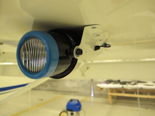

Likewise the power line supporting the landing light was hidden in the same strut.
air line connectors for the pitot tube
The landing light
The landing light
