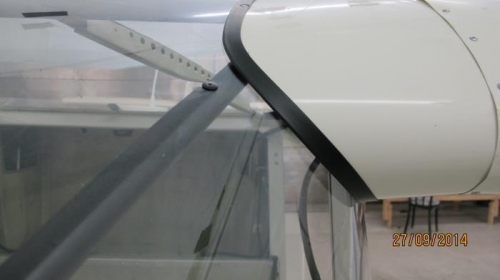

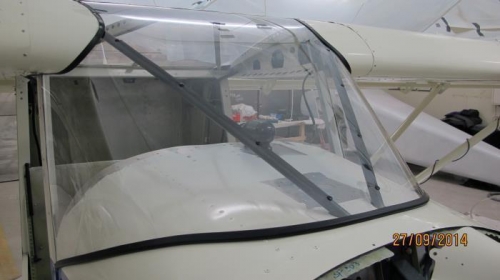

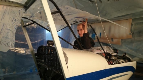

With the help from my friend Dennis this part went without any major problems although we had to search too often for hidden pieces. There were also a few misdrilled holes from previous attempts but all in all no sweat. I decided to add a spongy tape between the window and the cabin frame too induce a constant pressure from the rivets and, hopefully, avoid possible rattling against the frame. Later, I will put some kind of wide tape over all rivets in the window and on the roof just to avoid water penetration. I think this is important in the long run.
I used a modified version of the Al-profile to fill the gap between the window and the wing (pict3). Thanks for the template Nate! It wasn't easy but it worked better than the icp standard version.
Dennis with the window
Window in place
Window in place
Fitting wing to window with the template
