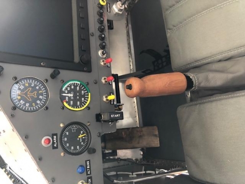

I finished testing the fuel flows today. All attitudes are testing out very consistently at 24 GPH +/- .5 GPH. I also looked at the fuel sender. I found that it was connected to the EMS module correctly, but it was not grounded. I ran a ground wire and it seems to be varying voltage appropriately with fuel level changes now.
I replaced the starter switch with a guarder toggle switch. The switch is spring loaded to the off position to avoid it getting stuck in the on position.

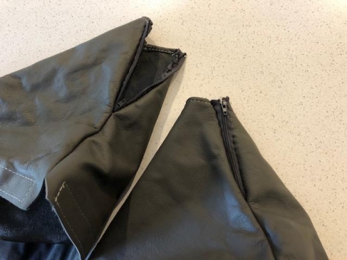

I finished the control stick boots and installed them. I opened the stitching up and sewed in zippers to allow them to slip over the larger stick grips and zip shut.
control boots with zippers.
New starter switch and Control boots installed
