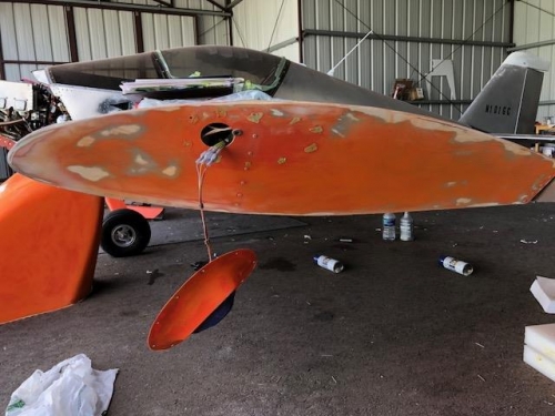

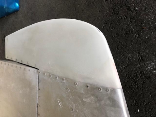

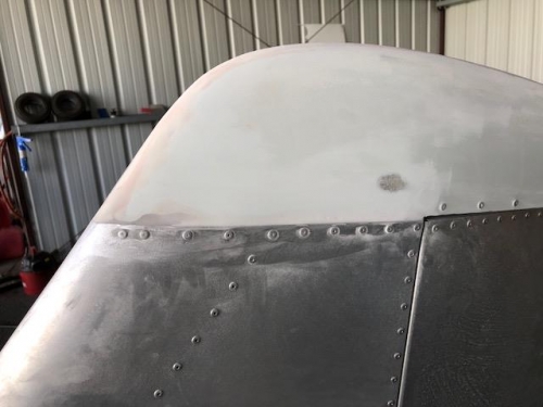

I spent all day sanding down and profiling the micro balloons I used to contour the wing and tail tip fairings. The aluminum to fiberglass areas are looking much better now without the gaps and poor fit I had earlier. I also cut and sanded the wheel fairings to fit the larger main tires. I finished glassing in the left hand cowl where the hole for the oil drain was. I drilled a hole in the right cowl to allow fuel to be sumped.
