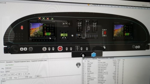

Today was the toughest, most frustrating day I've ever had. Started out trying to make the simple fuel line between the fuel valve and the post pump fuel filter. Tried multiple times, but each time I either gouged the fuel line, not good, or screwed up something or other. The line ended up being too short for me to be able to make the proper bends, and then use the flaring tool with the sleeve being on the line. Which it has to be. Finally, towards the end of a curse filled day, I decided to move the fuel valve from the previous builders location, more towards the seat. That gave me more room to fit the fuel valve lines going in and out. But that's tomorrow's stuff.
On the fun side, started playing around with my panel plan.
Panel plan.
Panel plan.
