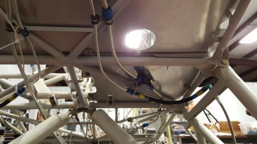

Brief Description:  fuel valve and fuel lines
Like I said yesterday, today, super bowl sunday (51), I moved the fuel valve. That involved redesigning the fuel valve support plate. I drilled out the rivets to save the platenuts, recut the plate, drilled the holes, installed the platenuts, drilled out the 1 inch hole for the valve handle. Then I drilled the pilot floor for the handle to pass through, and then installed it all. Then I re made the line from the fuel pumps to the valve, and then the line from the valve to the firewall. There was no room for the post pump filter so I'll install that on the firewall later. Then I enjoyed the best superbowl comeback in history, and Tom Brady and the Pats victory.
Old fuel valve hole.  Patch coming.
