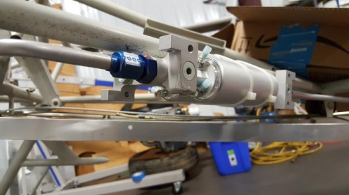

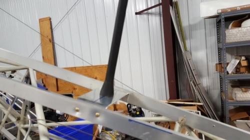

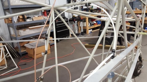

Mounted the ELT antenna, forgot about the trim cables so I ordered a 90 bnc connector so that the cables wont interfere. Then I put in the static ports and ran the tube to the panel area. Finally, I modified the fuel pumps bracket so that it will not rub on the skin.
