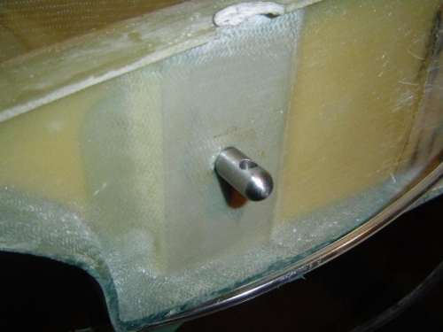

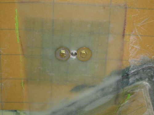

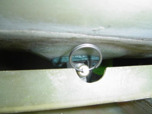

Wing Pins
The last thing on setting the wing incidence is to fix in the wing pins with Redux. I saved this until last because I may have had to remove them at some stage. The Rear pin has to be set with the pip pin so the holes line up correctly.
Rear Pip Pin
