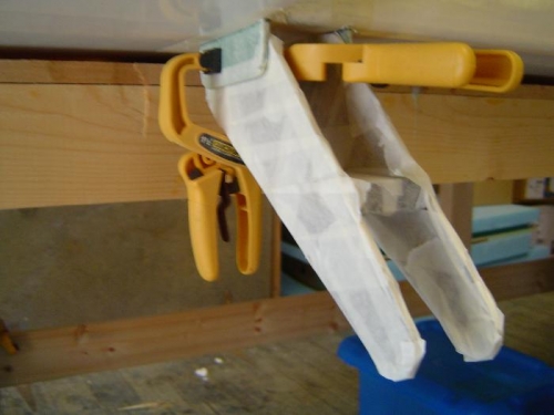

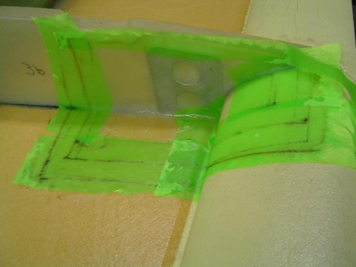

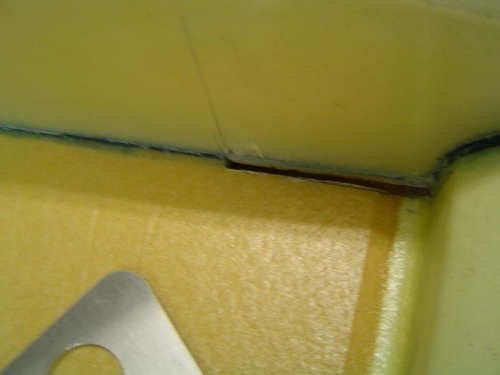

Brief Description:  Prepared the w18 flap hinge plates for bonding in
Prepared the w18 flap hinge plates for bonding in. They are bonded in by holding in place with small pegs then 3 plys pf bid are lied up with a flox filet. The two outboard W18 are fitted the same way and the flap hinge is placed in-between to get the correct distance apart.
Cutt the slot
Cutt the slot
W18 bonding in
W18 bonding in
Correct distance apart
