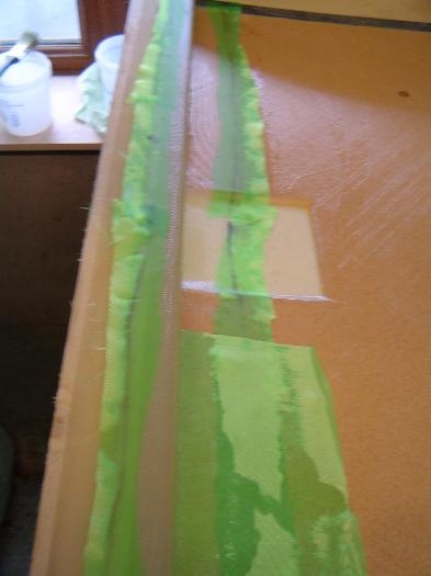

Aileron re-enforcing
Aileron re-enforcing completed the same way as the spar to skin. First added a wood straight edge to keep things stiff and straight while the resin sets. Added a filet of flox then 2 plys of bid
