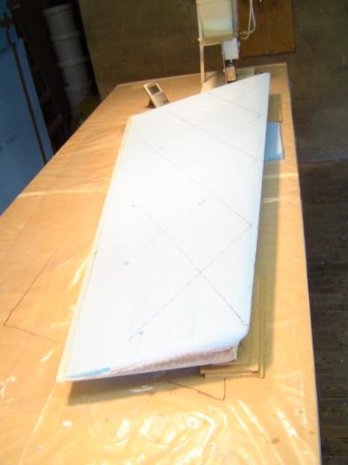

Brief Description:  Second Lay-up Prep.
Prepared the rudder for second lay-up, sanding down the edges, then digging out the flox corner at the T.E. root and tip. Set the rudder in the jig block as was done for the first side Lay-up, had a few problems getting a real good straight edge at the L.E. all looks good now and all ready for the second lay-up
