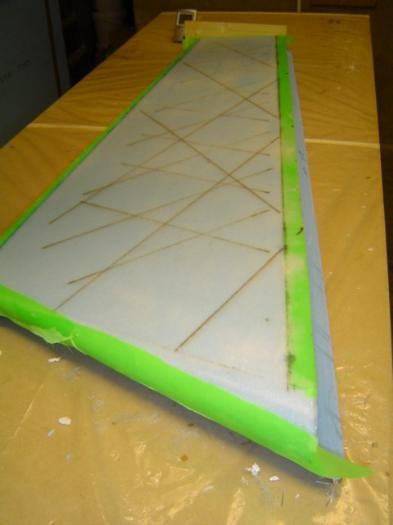

Brief Description:  First Lay-Up
Did first lay-up on the rudder, ( the real building has now started !!! ) With the help of Graham Singleton (PFA Inspector) he helped with the all aspects of the cloth lay-up with lots of very useful tips and tricks, which will help me along the way, ( had to re-draw the 30o lines on the rudder for the guide for the cloth, as I had marked incorrectly. (Spotted just in Time) All went well, left now to cure over night
