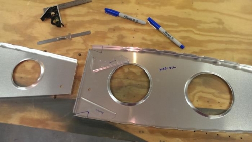

Brief Description:  Cutting Clearance Notches in Aft Ribs 1-5
Started marking the cutout locations on the forward side of the aft ribs. Ribs 1-5 must have cutouts where they join the wing spar so that they clear the spar caps. After if figured out what the plans wanted I only got the 01L & 01R aft ribs cut.
A good suggestion by another builder is to make sure that all the ribs are marked with their corresponding part number once the cuts are made. It will make it much easier to place and find the ribs later.
Marked Cutout Locations
