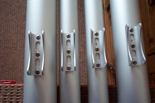

Installed the 3/16" nut plates to all hinge locations on the trailing edge spar.

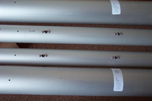

Drilled the strut atach holes to 3/8" with a unibit step drill to get a tight fit between the anti-crush bushings.
Installed the anti crush bushings into the spars.

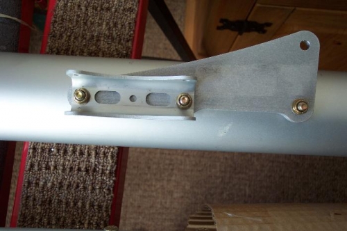

Bolted the strut attach plates and long wing channel to the leading edge spars.
Bolted the strut attach plates and the U-Brackets to the trailing edge spars.
3/16" Nut Plates

Stut Attach Plate
