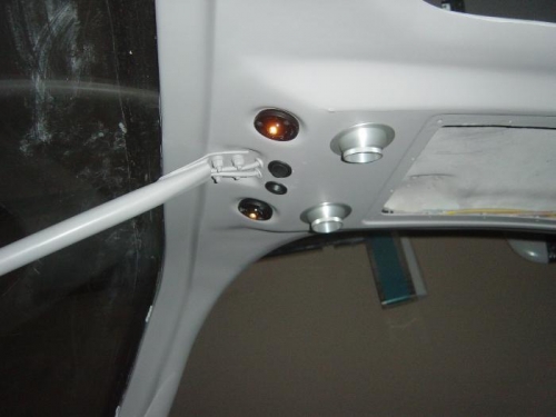

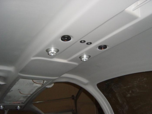

The kids left to return to school this afternoon and I slipped back out to the garage and finished wiring the LED lights and switches in the overhead console/plenum. Installed the fwd lights on their own circuit, tested everything, then cut to final length. solder, shrink tube, and install in respective sockets. Then, attached pigtail wires to each of the rear seat lights and switches and repeated the same process. with the exception for the wires in the immediate vicinity of the lights and switches all of the wire is enclosed in the poly tubing to avoid it being whipped and worn by the pressurized air in the plenum. I'm a bit underwhelmed by the amount of light these put out. I turned out all of the lights in the grage and turned on all of the lights, I does provide some visibility, but not enough to read by, Which means that it probably will not have too great of an effect on night vision detiorization. I still need to install the bagage area light and switch and install an 'inline' fuse to act as a battery buss for these lights. When the O2 system arrives I'll install it into the overhead closure and that should complete the overhead.
Front lights and switches installed

Aft LED lights and switches.
