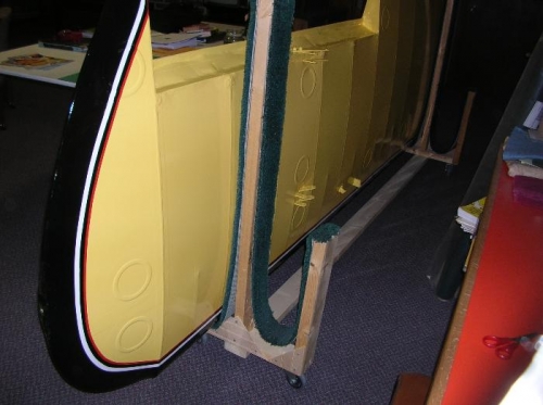

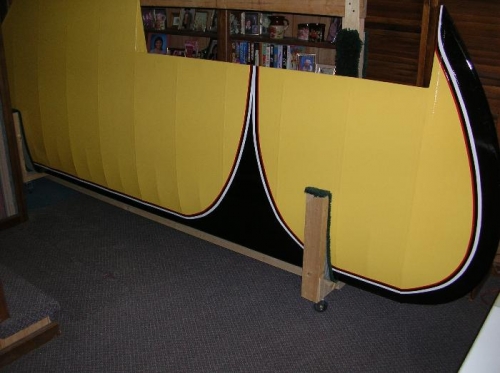

Brief Description:  Painting Upper left Wing
After completing the fabric covering on the upper left Wing Charcoal UV primer was applied with two full cross coats. These coats were then sanded and the Wing was moved to the paint booth and two cross coats of white fill was applied. These were sanded and two cross coats of Lemon Yellow were applied. These were sanded and the Wing was then masked for the final paint scheme and the Black and White scheme was layed out, masked and each color painted. The trim was then masked off and the final coats of Lemon Yellow were applied. The Top Upper Wingis now finished. The Upper Right was installed on the rotation stand and moved to the paint booth and the White and Black scheme was layed out, masked and painted on it too. It is now ready for the final Lemon Yellow coats but I need to order more paint from Stewart Systems in order to proceed. I'll do that after our upcoming trip to see the Grand-Kids.
Upper Left Wing in final paint-top
Upper Left Wing in final paint - bottom
