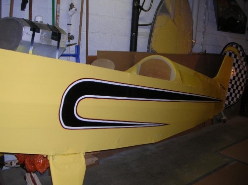

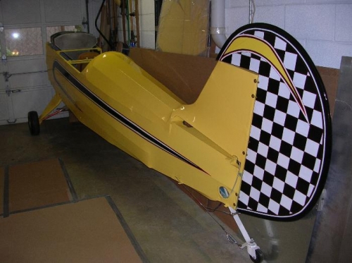

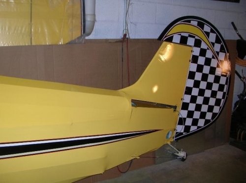

Assembled my paint booth (made from 1" PVC pipe, duct tape and semi-clear plastic) in Jackie's side of the Garage. Final sanded the Fuse, bought a new HVLP Spray Gun, then mixed up enough paint to give the Fuse it's final 2 cross coats of paint. Came out pretty good, (the new gun is a vast improvement). The Stewart System water-borne polyurethane paint produces a great gloss coat (as is clear in the pic's). I've now moved the Fuse (after attaching the Rudder) out of the paint booth and along the wall in the same side of the garage. The Stab and Elevator are wrapped in plastic and are standing up against the wall behind the Fuse in the Pic'.s.
