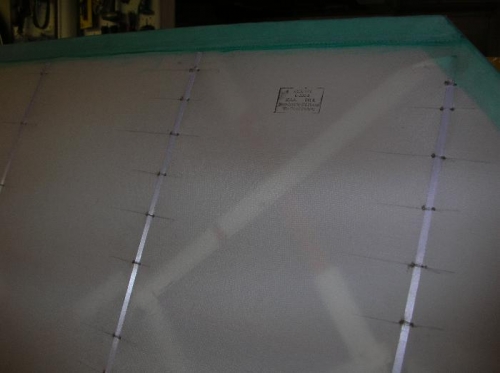

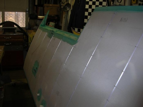

Mounted the Wing on the Turn Frame and began the Covering process. 1st the Aileron Bay area and the Root end, then the bottom fabric followed by the top fabric. All was Heat shrunk per instructions. Rib re-enforcement tape was applied to all rib surfaces and all ribs were rib-stiched. Stiches on the two inboard ribs are reduced by half in spacing to protect in the Prop Wash area. All other ribs are standard spacing.
Tape was applied to the trailing edges as all other tapes overlap these. Photo's below show this work.
Rib Stiching
Rib stiching - shows wide spacing on no prob wash area
