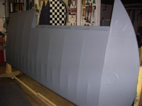

Rt lower Wing top in Eko Fill

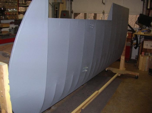

Rt lower Wing Bottom

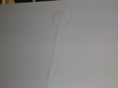

Rt lower Wing grommet shot in Eko Fill
