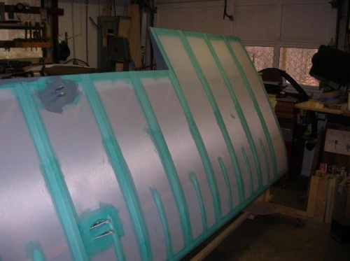

Rt lower Wing ready for Eko Fill

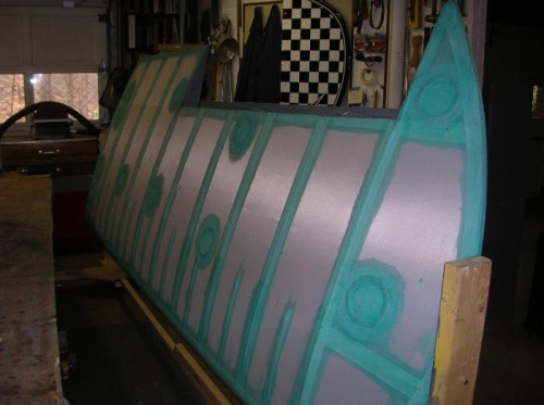

Rt Lower Wing Drain Grommets

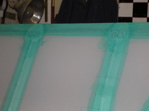

Rt lower Wing -bottom side
