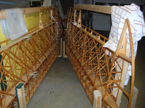

Brief Description: Wings - Final check/repairs/varnish
Put each of the three remaining Wings on the Work table and went over each and every joint and connection. Checked that all Aluminum parts are bolted on as per drawings, repaired any problems added additional epoxy to any joint I thought looked weak. Sanded all parts where needed and then polyurethaned all surfaces by brush. Two coats and when dried placed each one again in the roll around rack to allow polyurethane to completely dry.
Wings in Roll around racks now varnished - all of them
