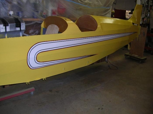

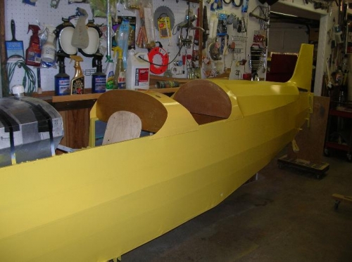

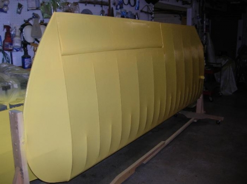

Painted the Fuselage and rt top Wing with Lemon Yellow Stewart System EckoPoly. Nice paint but I'm not happy with the way it went on. Believe I have a Paint Gun problem. I have too much "orange peel" in the paint to suit me. Sanded it to put the swipe on the side of the fuse and it sands and smooths out very easy so I'll just sand the whole thing down again with 320 grit in the future - fix my gun issue (if that's what it is" and get the finish I want to see. The paint has a great gloss to it when done right and is easy to mix and apply. Cleans up easy
Fuse in Lemon Yellow
Wing in Lemon Yellow
Fuse with Paint Scheme
