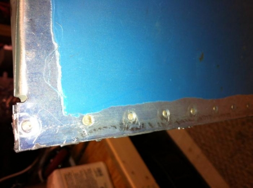

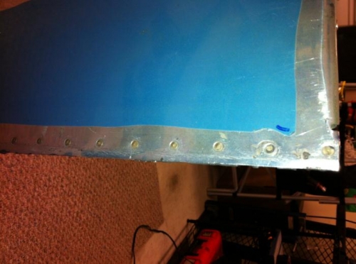

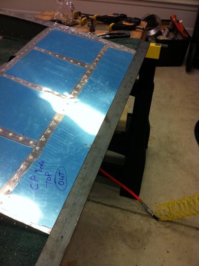

Brief Description:  Finishing the Elevator Trailing Edge
Today I finished the trailing edge on both elevators. I riveted all rivets from one side thanks to my new long piece o' metal from Lowe's. It worked perfectly (a tip I had seen from other builders' logs.
Also, I didn't have to use any rivet tape thanks to the small bit of proseal in the holes.
All of the rivets were perfect until I got to the last one. Of course you know that one wanted to be off just a bit. Oh well...easily fixed. All of the others turned out very well and I'm pleased.
The trailing edge is very straight.
