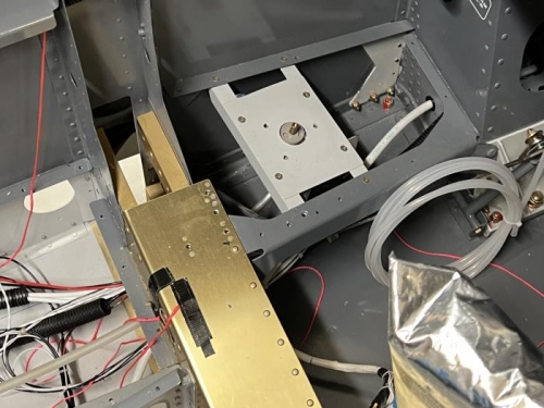

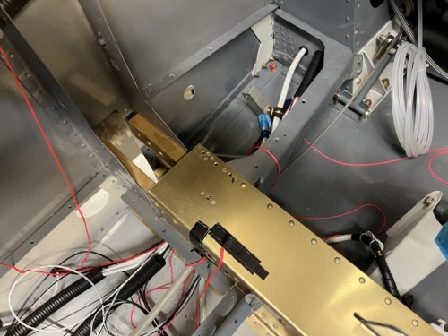

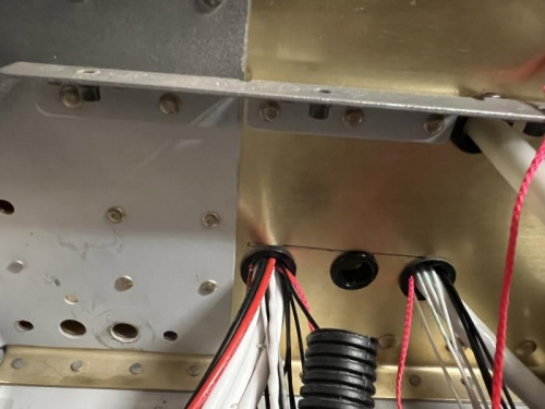

With the goal defined, one of the remaining jobs is running the Pitot/AOA tubing from inside the wing to the boxes behind the panel. We looked at the wing and the best way to get it tubing behind the panel is to go through the spar web under the left console and up through the left gear tower. This sounds like a simple step, although, at this point in the build, there are many things on both sides of the wing spar that keep a guy from being able to drill a nice, easy hole. The process of drilling a hole in the spar web, not drilling into the spar and anything of value on either side of the spar, is time-consuming. We had to remove the fuel selector valve, the fuel filter, and most of the fuel tubing, which is forward of the spar to be able to drill the hole front-to-back into the spar web. So, in the end, only two holes drilled and two snap bushings were installed, but it was done safely, and that was a huge win for the day.
Before the removalof the interence
most ofthe fuel system under the left console removed
Hole in center was drilled through both spar webs
