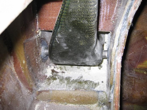

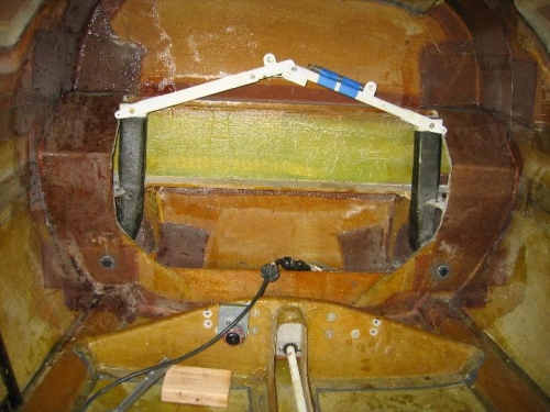

Brief Description:  Install main gear bushings
Repositioned gear legs slightly so that they would match the socket notches provided by the factory in the fast build process. In order to do this, I repositioned the steel insert inside the legs and retrimmed the gear leg holes. The top of the gear legs lined up quite nicely when this was done. I also insured that the aluminum bushings protruded slightly inward toward the gear legs. When all that was done, I used structural adhesive and flox to permanently install the aluminum bushings and steel insert.
Pilot side (note steel insert either side of leg)
Over center linkage temp installed to keep gear lined up
