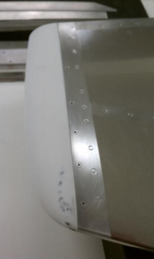

Fiberglass tip final install

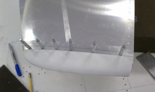

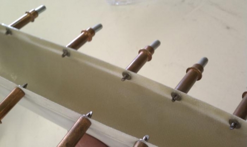

Match drilled in place. I then added some washers to the fiberglass flange so the pop-rivets will have somthing to expand against. In stalled the tip with JB Weld and then machine counter sunk the skin and installed flush pop rivets.
pleased with the out come!
Drilled and Cleco'd on
Backing Washers
