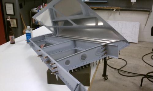

Manual Reference:  Drawing 6a
Brief Description:  Final Assembly of the Vertical Stab!

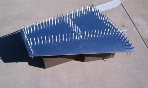

All the primed parts cleco'd together and ready for final.
Order of operations:
1. End rib and center rib to spar
2. Skin to spar top bay.
3. Skin to spar lower bay.
3. Center rib to skin.
4. Center rib to spar
5. All the way around the outside flanges. (tip,root, T.E. spar)

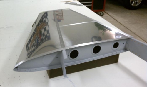

QC Check and done! Only had to drill out two!

Heat the skin up for riveting
A real no kidding servicable aircraft component!
