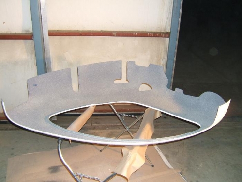

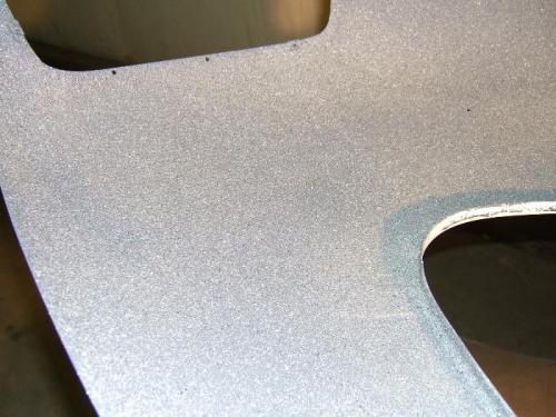

Sanded the edges of the glass doublers I added to the left cabin door opening and re-opened the holes for the lower door latch. Sanded and cleaned the inside of the left cabin half then primed and texture painted the interior as I had done with the right half. I think the cabin is now finally ready to go to the painters.

Left cabin half interior paint
A closer look
A closer look
